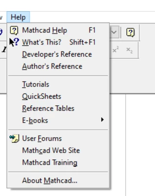

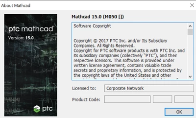

See if you can find it here:
Go to Help and Click about

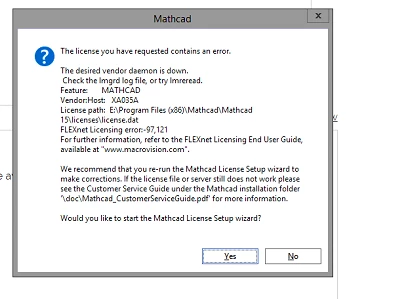

I cant launch MathCad 15 since I am getting this error. This happens when we move away from vmware to proxmox.
published picture does not enable me to provide you any valid information. I should have your license file available.
Note: I have no experience with proxmox.
