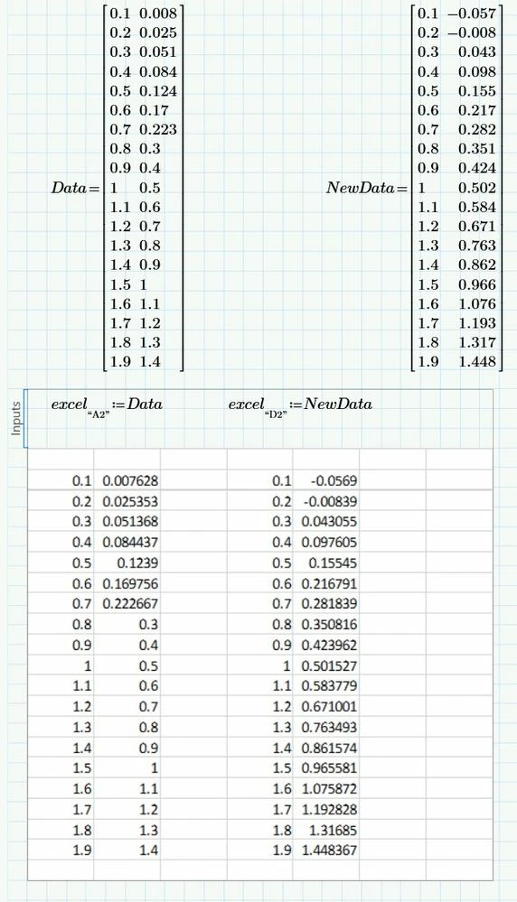

Hello everyone,
I have something to ask, and maybe it's quite easy to ask. But I couldn't find any source about it. I created a chart from curve fitting, and I want to see the chart values in a table. If it's necessary, I can add the file. 🙂

It is simpler to provide advise if you include the file.
Cheers
Terry
terryhendicott
Aug 29, 2023 12:27 PM UTC
Hi You can display the original data and curve fitted data in a table as a matrix or using the Excel Component
