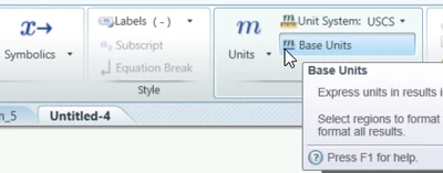

ft^3 instead of gal - use base units:
kip instead of lbf - no way. (At least until we implement custom unit systems.) You will need to re-scale each individual equation.

But when I change to base units, yes, it resolves the gal/ft^3, but it messed the "lbf/kip", it changed them to lb.ft/s^2
