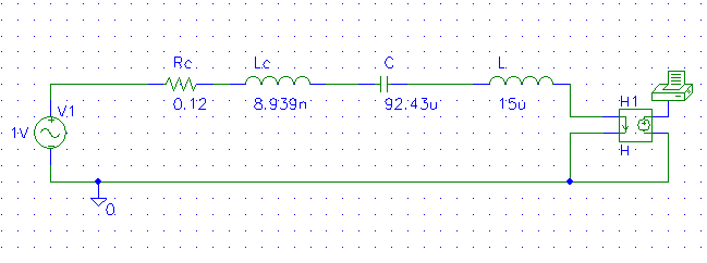

If you set up the schematic in Pspice, be sure to insert an H device (current to voltage converter) in series with your impedance.
Connect the lower output of the H device to ground, and to the upper output you connect a print symbol. This will allow to print the current flowing through your impedance.
Your schematic might look like:
Now run the simulation and afterwards check the Pspice output file. You'll find a table like this:
  FREQ   V($N_0006)
   1.000E+00   5.808E-04
   1.047E+00   6.081E-04
   1.096E+00   6.368E-04
   9.550E+09   1.110E-06
   1.000E+10   1.061E-06

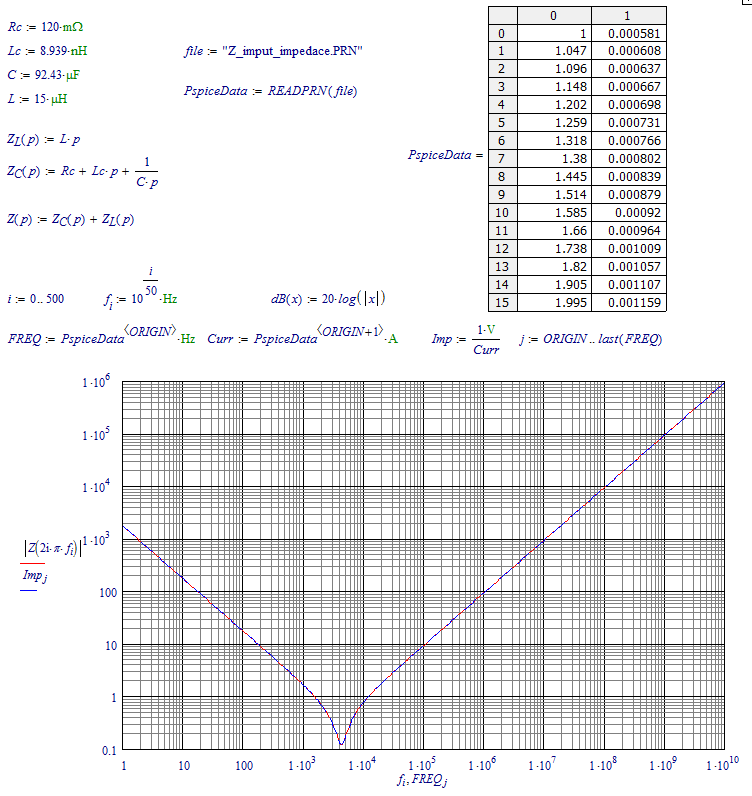

Copy this table over to a new text file, just the data values! (forget about the FREQ and V(... line.
Now you can read it in with Mathcad.
As you can see, the (solid) red line of the Mathcad model coincides with the (dashed) blue line of the Pspice output.
