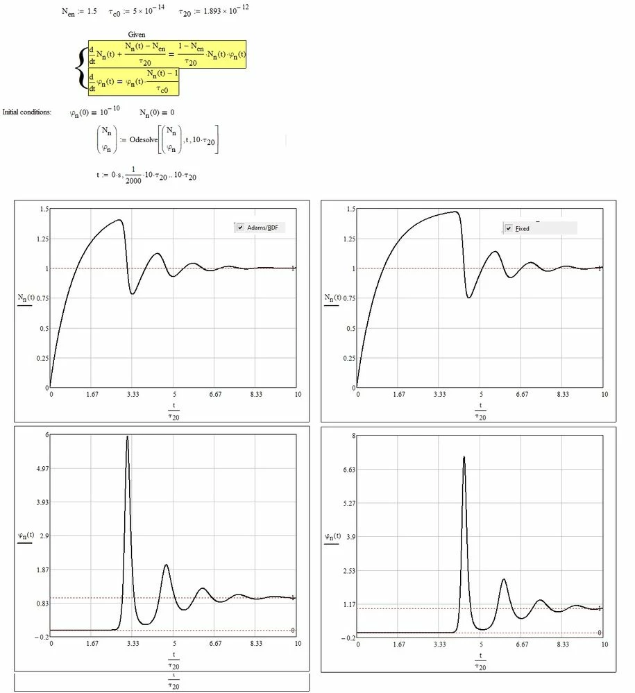

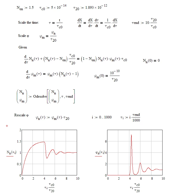

If you do a little rescaling you find the result is independent of the algorithm.
ttokoro
August 6, 2021
The shape is depend on TOL= 10-1 to 10-7. Prime 7.
t.t.
August 6, 2021
-MFra-21-Topaz IIAuthor
August 6, 2021
Your results are the same as those obtained with the "Fixed" or "Adaptive" algorithms so I choose one of the two without changing anything. Anyway, thank you very much for the helpful advice.
