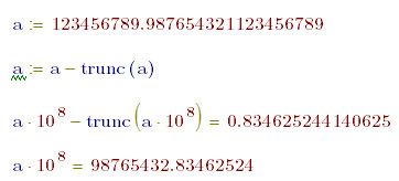

When I use:
x:=x-trunc(x)
x:=x*10^8-trunc(x*10^8)
to get the number after 10^-8, I get a lot of number irrelevant! Look at the picture below:
In my opinion, the result must be 98765432.11234568, but MC return a unacountable number! Is it another bug of MC15?

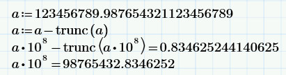

In Mathcad Prime 2.0, the result is same:

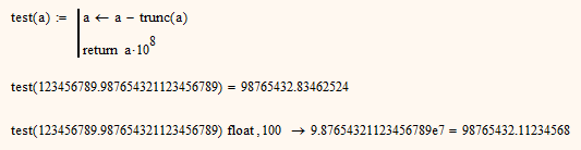

BTW, you may be able to use symbolics in a program too (at least you can copy a symbolic eval in a program in MC15). Furthermore you can evalaute your programm symbolically which may give you the accuracy you'd like to have.

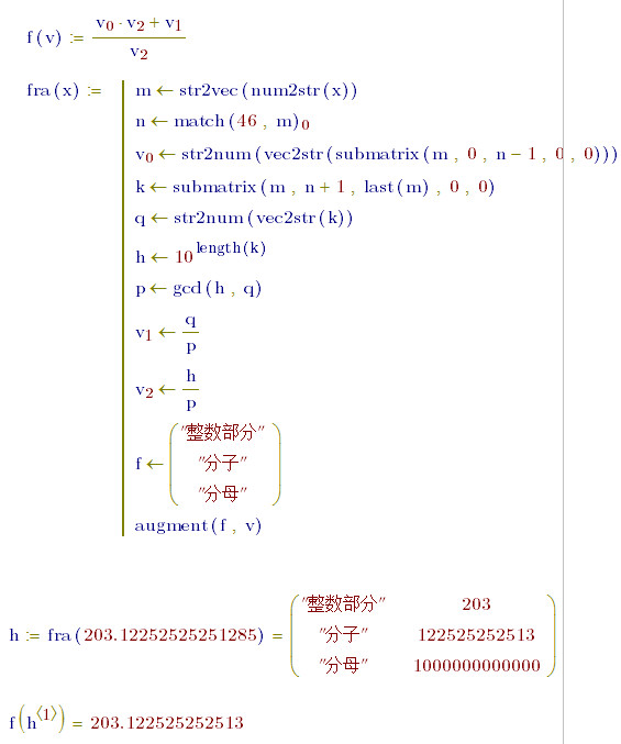

I want to create a program that could translate arbitrary decimal to fraction. When the significant figure of the decimal less or equal than 16, my program work well, but when it large than 16, it will return a wrong result.
Eh, this program can't use x-trunc(x) to get the decimal part of the number, and I have try 20.12355, and when use x-trunc(x), the decimal part has been returned 0.123550000000016. So I translate it to string and process it.
But, Just like you have seen, when the significant figure of the number is large than 16, the result is wrong.
