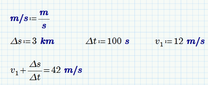

I want  to input "/" in Mathcad Prime 3.0,such as 3 m/s,the "/" also can be calculated in my document,is it possible?

Do it please in Mathcad 15 and convert the file into Mathcad Prime!
Or use my sheet in attach!

If what Valery had shown is what you are looking for - you can easily create on your own:
1) Type double quotes and inside type the expression with the / sign
2) Delete the quotes
3) label the new expression as unit (just for consistency)
4) Follow the expression with a colon and add the meaning of the expression, so you can use it correctly in your calculations
