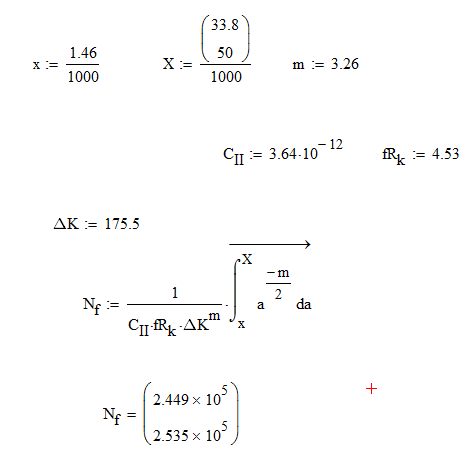

Hallo,
i have a short question for how to write this integral correctly with vektorising.
At the moment its not working.
I need this vektorised because i have different loadcases ands different "xc" values.
Would be nice if anyone can help me
Thx best regards Stefan

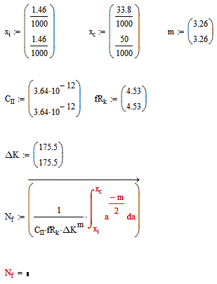

January 4, 2017
also the other factors example "m" is different for every loadcase....

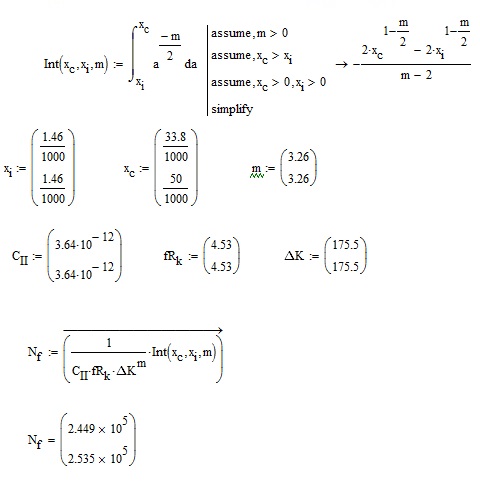

January 4, 2017
Hi Stefan, that's okay ?
January 4, 2017
Thx!
so you did the integration separatly without borders just the integral and then you calculatet the vektorising function with borders.
Hmm but why is my vektorising function not working i set the arrow over the hole formula.
Yes that does look correct the assume seems to be correct yes.

You don't have to make everything a vector, if a value doesn't change, leave it a single value
January 5, 2017
THx for answers!
I could solve the problem!
