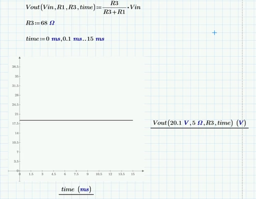

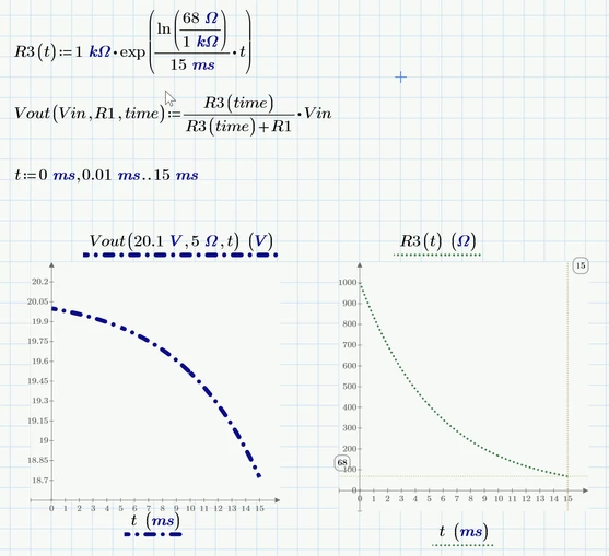

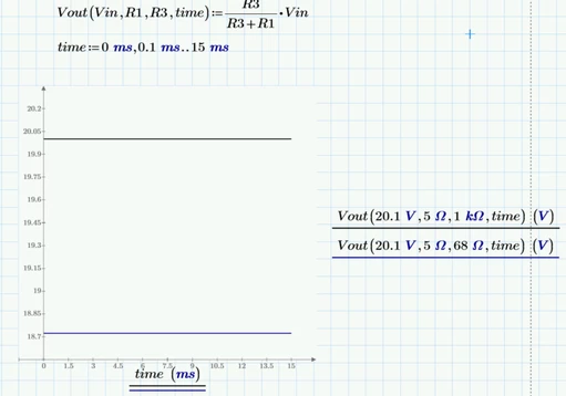

Your function Vout is not using the "time" argument at all!
And your plot is not using R3 at the abscissa, so you get all constant values.

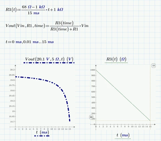

How should Vout change dependent on the time?
Maybe you have to define R3 as a function of t ....

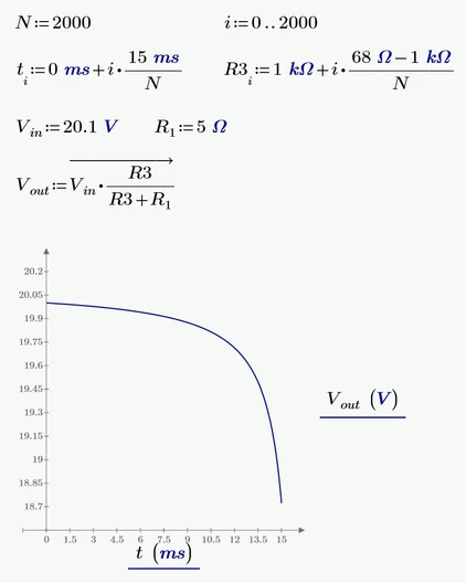

In this example I assume a linear relationship between time and resistance R3
And here an exponential relationship between time and resistance R3

Werner_E25-Diamond IAnswer
Mar 7, 2024 9:41 AM UTC

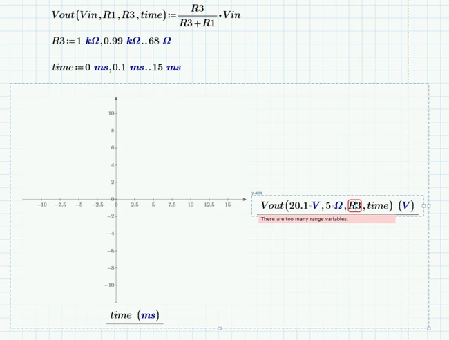

Cornel19-TanzaniteAuthor
Mar 7, 2024 10:13 AM UTC

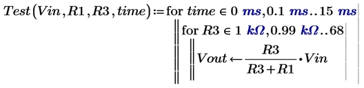

All variables are depending on time...
Your first answer is good, I mean that with linear relationship between time and resistance R3.
I was thinking at 2 for loops, something like that:
In this way I think if I will have 3, 4, or more variables that I need to iterate then maybe will be more easily to add another for loop, but I do not know exactly at this moment if this way is possible and a good way

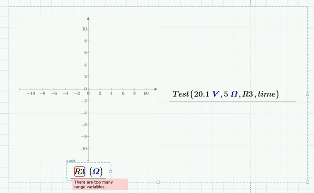

Mar 7, 2024 10:34 AM UTC

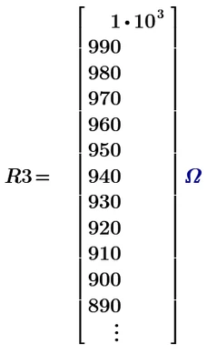

Unless you want the two variables to 'iterate' independently from each other (which would result in a 3D surface plot)  you have to specify in which way one variable should relate to the other and this is done by defining functions.
A (IMHO bad) alternative would be to provide t and R3 as equal length (!!) vectors
Ranges are to be used in three occasions only:
1) To index the elements of vectors and matrices
2) as the independent variable in a 2D XY-plot (and there is only ONE independent variable in a 2D XY-plot)
3) in a program when you use a for-loop
