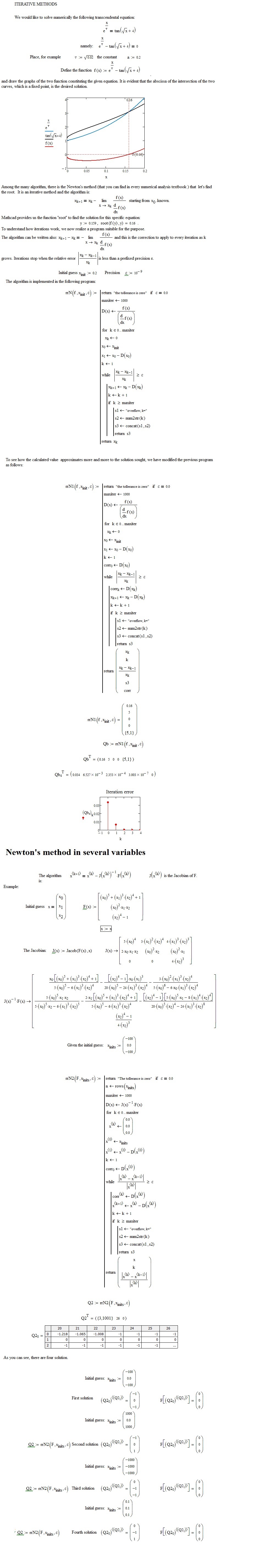

Here's an example of Newton's iteration method to find a square root.
May 5, 2016
Certainly, will be useful the following two examples. In the first, a transcendental equation is solved with the iterative algorithm of Newton. In the second one it solves a system of equations with the same iterative method but in several variables.
Greetings
F.M.
