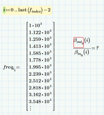

Maybe that way

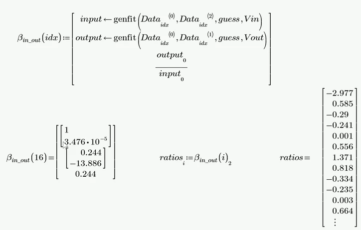

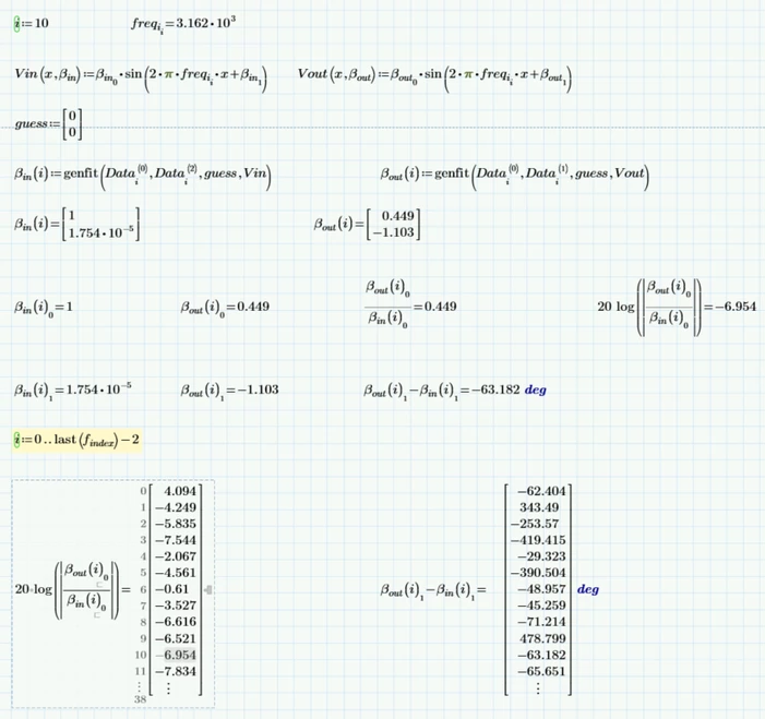

If that ratio is all that is of interest, you should modify the function beta.in_out accordingly so that it only returns that ratio.
Another way could be to turn each of the "genfit" calls into a separate function of the index:

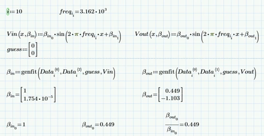

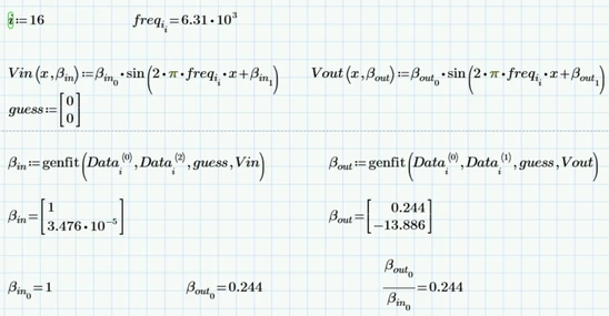

Cornel19-TanzaniteAuthor
Apr 22, 2024 10:34 AM UTC
Yes, the second variant.
But look:
How to extract each i from the above two vectors?

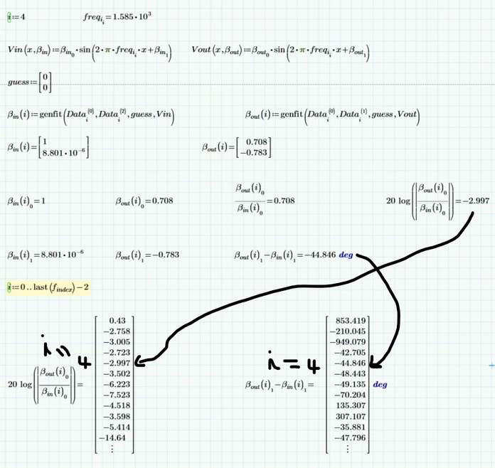

Apr 22, 2024 10:39 AM UTC
I don't understand what you are looking for!?
The values you calculate singly for i=4 and i=10 seem to match perfectly with the appropriate values in the calculated vectors.
I see no problem or error here.

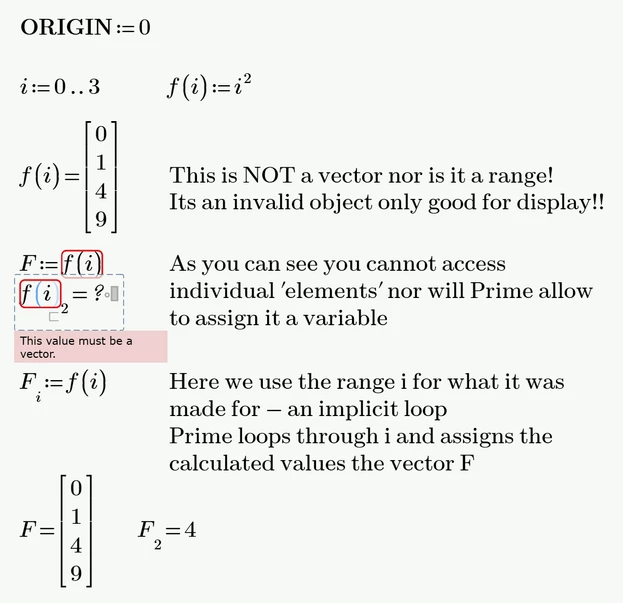

Or could it be that you stumble across this age-old problem??
If that's the case you may have a second look at how I defined the vector(!) "ratios" in my answer above!!
