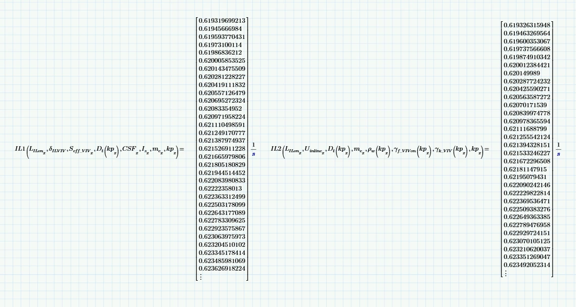

How to limit in equal to
Hello, I have a question. As you can see in attached picture, i want to create function if IL1 equal to IL2, but I want the equal to function to only consider 4 number of decimal places (ie: 0.6193). Is it possible? I use Mathcad Prime. Thank you

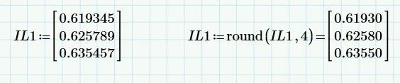

Math formatting only affects the way it is displayed it still is operating at full accuracy.
The trick is to use the round feature then compare if equal.
It is possible to do this to whole vector at once

Jun 20, 2023 7:51 AM UTC
Try this: click on IL1/IL2 and then click on Math Formatting tab, and change to the Decimal, and then increase/decrease to the 4 decimal numbers:

7-Bedrock
Jun 20, 2023 9:03 AM UTC
Thank you verry much terry, It works.
Thank you Cornel for your advice!
