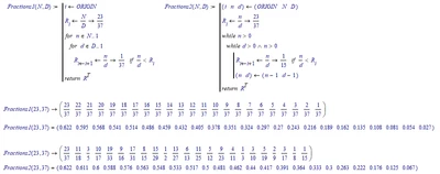

OK, I see. How about:
10 replies

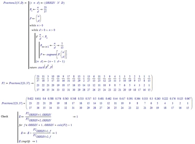

23-Emerald V
I think you want Fractions2:

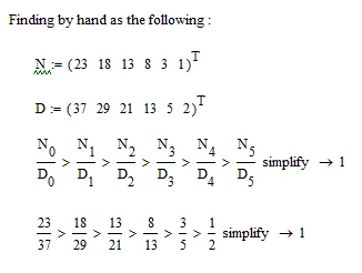

lvl10720-TurquoiseAuthor
20-Turquoise
It seems my question is not clear, Luc. With finding by hand then :
Best Regards.
23-Emerald V
Indeed, your question is not clear.
E.g. Why can 22/36 not be in the list between 23/37 and 18/29 ?
