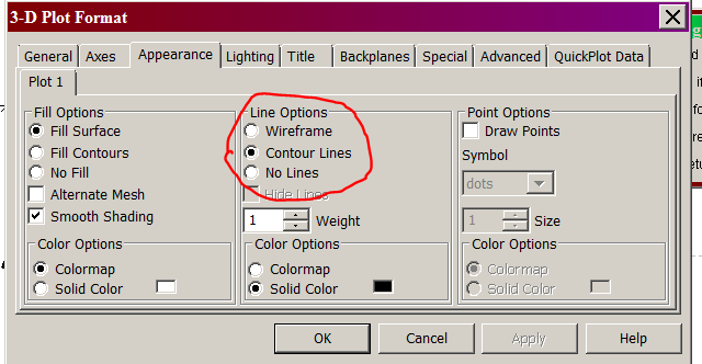

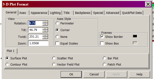

When i go in Contour Plot it shows me the lines perfectly but on the surface plot it shows nothing. Why?
Thank you very much
23-Emerald I
November 18, 2016
If you double-click on the 3D graph in the Mathcad 15 sheet, you get a plot format dialog:
If you click the Appearance tab, you get a dialog that allows you to select contour lines on your plot (or not.)
