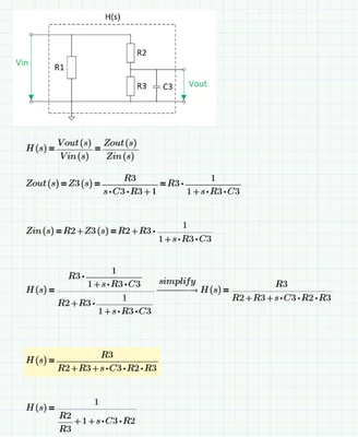

Hello guys,
please help me to solve this problem.
I would like to plot the magnitude and phase over a logarithmic frequency axis for a given transfer function.
In the first picture I create the transfer function with symbolic mathematics.

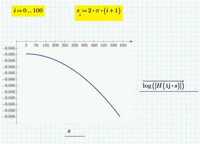

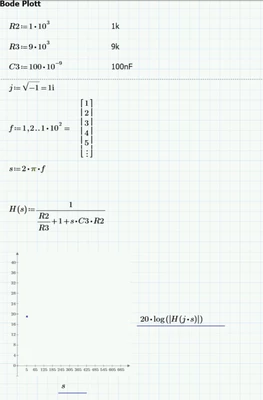

In the second picture I declare some parameters (but without units !) and I tried to plot the magnitude ...
The single point in the graph is unclear to me with a value of approx. 20 ?? All the values on the y-axis must be < 1 ... or < 0db

Hello guys,
@LucMeekes :
I did not upload my sheet because I know there are compability problems with different mathcad-versions. I am using mathcad prime 3.0
Anyway, I attached my sheet, I hope it helps!
@Fred_Kohlhepp:
Unfortunately it didnt work ... , but good idea with the variable i - in my case k -
Since s = 2*pi*k* I also dont like the steps with 2*pi = approx. 6Hz ...
How would you scale the steps of the x-axis to 1Hz, 2Hz, 3Hz, ...
Or even better: How do I scale the x-axis logarithmically? In that case the steps would be 1Hz, 10Hz, 100Hz, 1kHz, ...
Thanks in advance and best regards,
Dimitri

The attached pdf was created in Prime 4.0 Express.  Since you're using 3.0, the Mathcad file won't do much, but you can type the expressions--they should run in 3.0.  (The grid plot is a special, not part of what PTC sells, but you can have a logarithmic scale from the plot menu.
