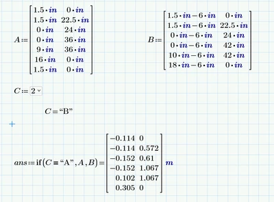

Hi Everyone,
I am sure I am not the first to ask but could not find any information on this issue. How can I have mathcad to show the matrix value after having the variable in combo box. Also, is there any option wherin prime will open all the worksheets in draft view?

How do I insert this is combo box to get it evaluated?
