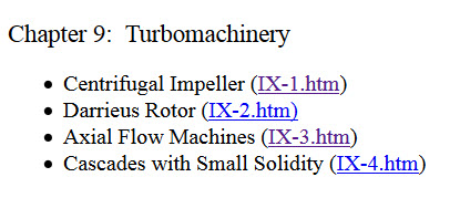

Not sure if this exactly what you are looking for.
You can see some great examples done by Dr J Alan Adams
http://www.usna.edu/Users/mecheng/adams/indexf.html
Links to the lectures will then allow you download the Mathcad worksheets.
Note the worksheets are all in Mathcad 2001i, if you want to use them in Mathcad Prime you will need to convert them.

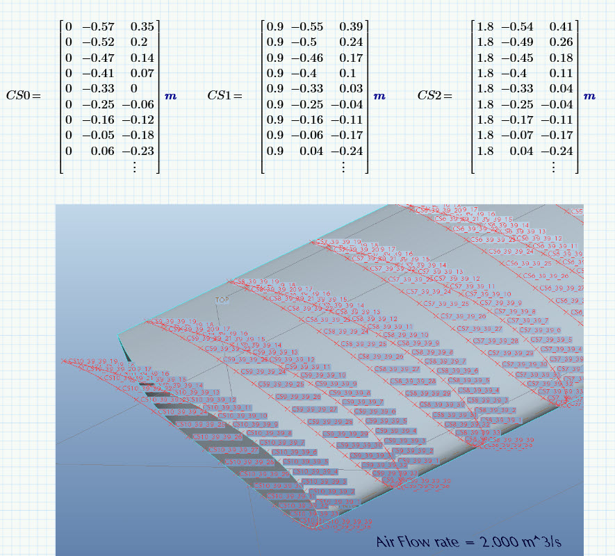

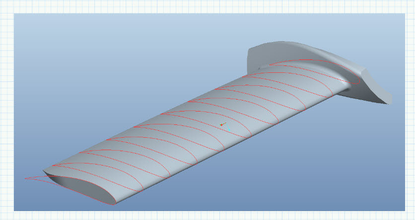

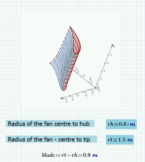

I took the worksheet a step further.
We can take the 2D profiles of the blade calculated (I modified Alan's worksheets on Axial flow machines)
Generate the XYZ coordinates and use the curves at specified intervals along the blade to recreate the solid part in CAD. (Creo parametric in this case)
In this example the centre-tip and centre-hub radii are varibles in Mathcad. (they can be associated with parameters in CREO)
Thomas
