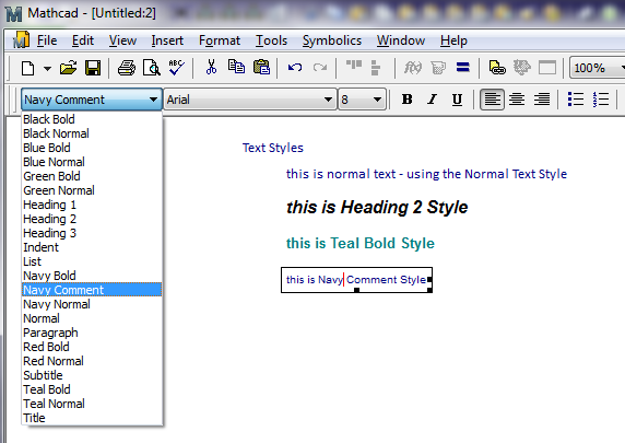

May be so?

Which version of Mathcad are you using?
What do you mean by "Headings like in Word"?  For example:
Do you just want to be able to create heading with different styles (eg, a larger font and bold text)? That should be straightforward in either version, but easier in Mathcad 15, as you can create your own styles (or use the built-in ones).
Or do you want to autonumber headings? ... if so, you're out of luck, unless you're using Mathcad 15 (or less) and willing to use a slightly unorthodox method.

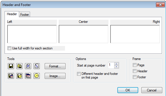

adeters1-VisitorAuthor
September 28, 2016
I am interested in formatting headings not headers
