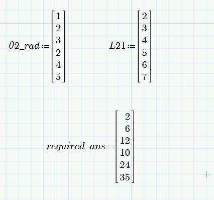

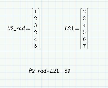

I have two arrays as shown in below snap, here i want to multiply both arrays ( matrix ) and answer should be as shown in second snap.
and I need answer with below form.

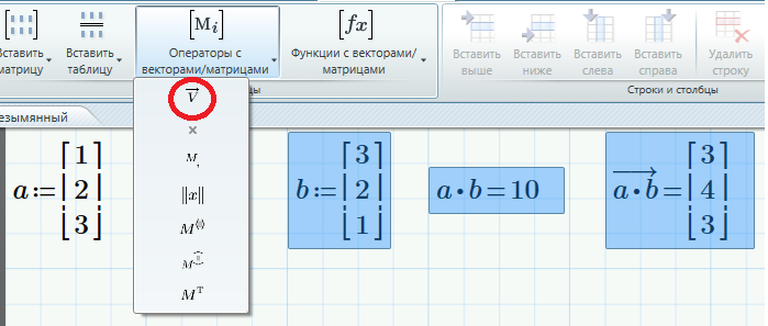

Best answer by ValeryOchkov
November 26, 2015
November 26, 2015
Thank you very much.
It works.
