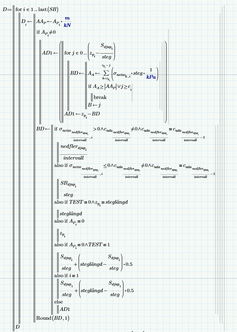

I have a MC15 calculation-sheet of 200 pages that have been converted to Mathcad Prime 9.0 that runs extremely slowly and which im now looking to optimize. Changes in input that in MC15 would have taken 5-10 seconds to recalculate can now take upwards of 5 minutes or more before the sheet is updated.
I've been trying to read up on ways to speed up processing in Mathcad Prime and have read that size of matrices, the use of If-statements and possibly the use of "strings" in aforementioned matrices may be culprits.
Which optimizations do you believe would bring me the biggest improvements in calculation speed as opposed to how MC15 was working?
Does anyone have any recommendations how i should go about rewriting If-statements? (see attached picture of an example)
Im going to see if i can break up the sheet in parts and work on a part separately. Then i can also upload said part here for you to partake in.

Hi Johan,
here are my two pennies for your issue:
  • Don't divide repeatedly. Create a variable once that is the inverse of INTERVALL and multiply with that instead.
  • Try to use LOOKUP functions. I found them to be faster than comparisons.
  • Try to split up your combined AND / OR statements into single ones checking first for one condition and the the other one. That way the second subset of variables to be checked is smaller.
Hope this helps because Prime's speed is glacial 😉
Raiko

Just wanted to reaffirm that i have been unable to improve speed by any significant amount. I tried putting in Time(t) variables at different stages of the program to see if one part or another is a specific time sink but unfortunately the "glacial" speed seems to be continuous throughout the worksheet.
The performance is unacceptable and i dont see us as a company continuing to subscribe to PTC/Mathcad unless we see significant improvements in performance in the near future.
