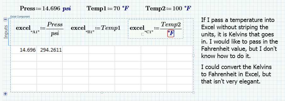

How to pass temperature into Excel?
Does anyone know of a good way to pass temperatures into an Excel component? The method of "stripping" the units by dividing by the units doesn't seem to work with temperatures. The workarounds I can think of are not very elegant. Thanks!

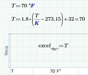

Jun 22, 2016 3:04 PM UTC
Thanks, Valery. I did think of converting K to F in the spreadsheet, but I was hoping there was a way to avoid that step. I guess not.

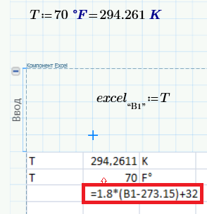

Jun 22, 2016 3:06 PM UTC
You welcome!
Second variant
