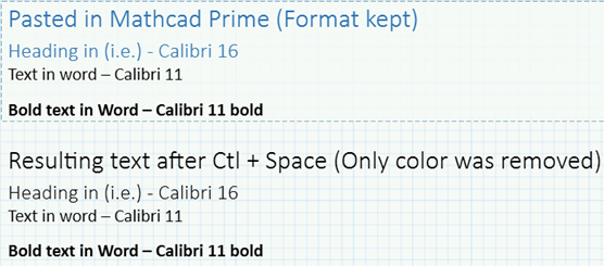

The problem is that you can't get rid of formatting:

August 11, 2016
Thanks Mark Gase, I tried this, and unfortunately it looks like only the color format was removed, nothing else.
August 11, 2016
It appears there are definitely some limitations to my suggestion.  If you copy a single paragraph at a time (no line breaks included in copied text), and paste it into an existing text box/block (empty or including other text), then Ctrl+Space will clear all formatting.  However, if you include any line breaks or try to paste into a blank area of the worksheet, then some formatting remains after Ctrl+Space.
