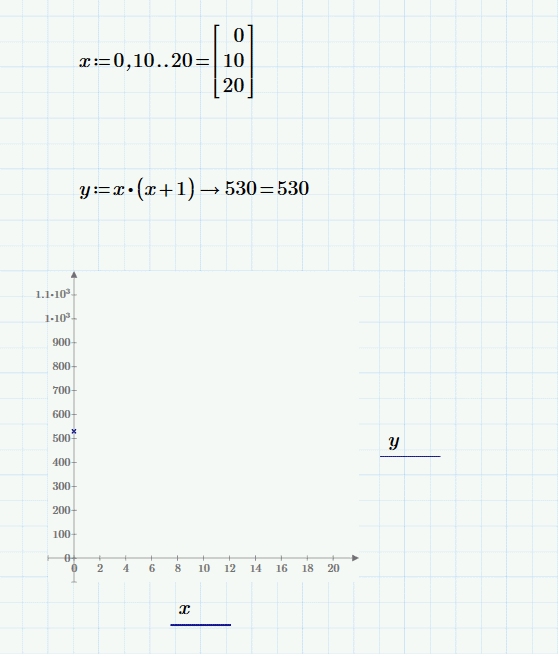

I'm trying to plot a mathcad xy graph but with results dismal.
As you can see from the image , since the variable is repeated the array of points become an integer again and so the graph just shows one point.
I know i could multiply the function so that it become x^2+x but this in not a solution since this is just an example for a much more complicated function I need to plot, that would become simply a monster if i would multiplicate all toghether.
Hope there's a easy solution for this problem!
Thank you

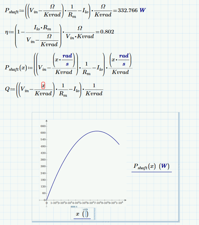

Hello ,
I solved apparently the problem was the unit definition. I have multiplied for the proper unit directly in the function and than changed the range of the graph appropriately, and this did the trick.

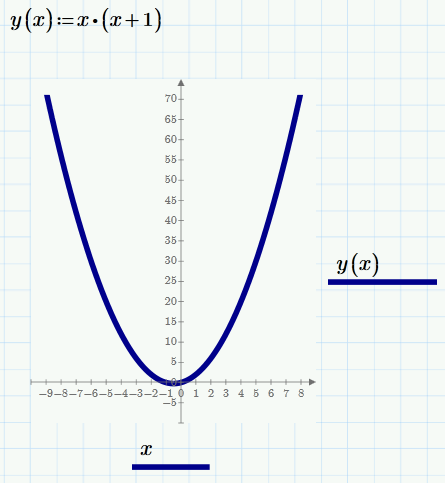

You have to define a function: y(x):=x*(x+1)
Then use y(x) in the plot, too.
You should in any case change your range variable x (you only define 3 points that way) or leave it away completely. You do not have to define x if you only want to plot unless you really want more control, but you can change the range of x directly in the graph, too.

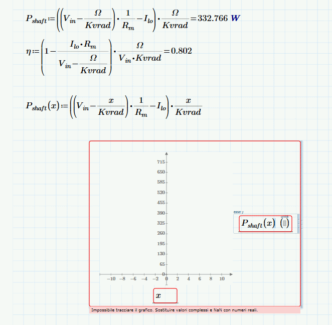

the reason why i define arange is because I need a larger range than -10 to 10 and besides the actual function I'd like to plot is this one:
As you can see no problem evaluating Pshaft when omega is given but if I try to plot the Pshaft(x) with x as a variable the program doesn't plot anything, if I define a range it plot just one point probably since it multipy the two matrices of points.
This issue is puzzling me !
Thank you very much!

Can't debug a picture, you will have to post your worksheet.
As you write of matrices: In your first posting x was neither a matrix nor a vector (despite the fact it may look like a vector). Its important to distinguish between range variables (which are kind of implicit for-loops) and vectors. From the pic it can't be seen if a variable is a range, scalar or vector. They should be scalars, by no means ranges!

Hello ,
