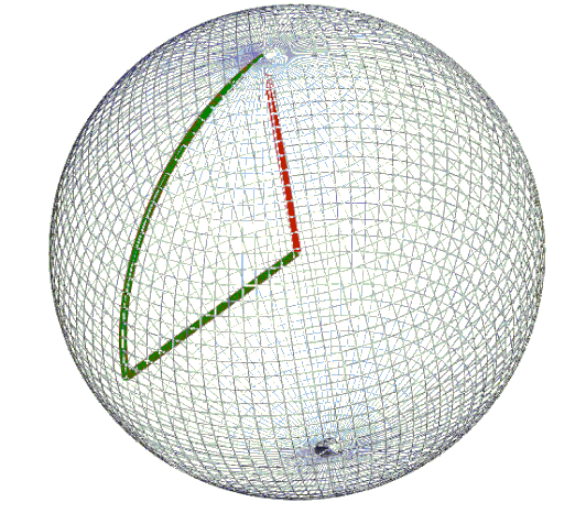

Sorry,.. my question is not clear :
How to plot an Arc go through 4 points ? ( start-point : red , end-point : orange )
Best regards.
Loi.

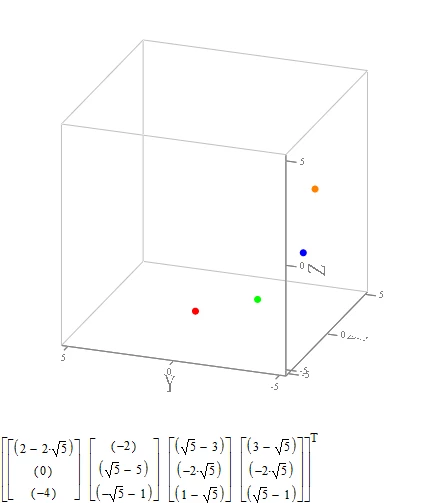

Aug 28, 2023 12:18 AM UTC
What kind of "arc"? You sure can't demand it to be part of a circle (which usually is defined by just three points)
In your example, by chance (?) all four points lie in a plane and on the same circle arc (with center in the origin). But this is not normally the case with four arbitrary points in space.
So if you want to envisage an arc of a circle, you must only specify three points, not four!
