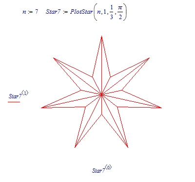

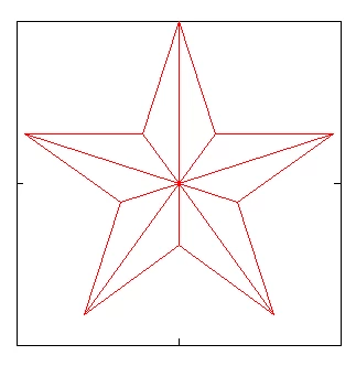

   Many thanks, Luc. Basic, my question almost was answered. But I still have a small query : the your "Star5" seems not being a "perfect star(5)". Say, compare your "Star7" with following figure that I would wish:
Would it be edited ?
  Best Regards. Loi.

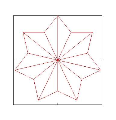

October 15, 2020
Play with the arguments to the PlotStar function.
The first defines the number of points. The second defines the size of the points, the third defines the size of the indents, the fourth turns the star.
