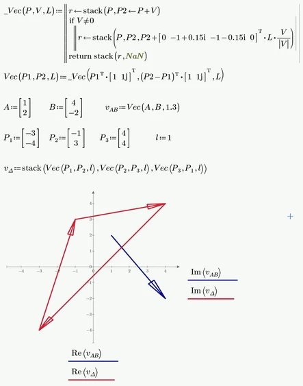

Werner_EAnswer
Sep 20, 2024 4:40 PM UTC
The function "_Vec" which basically stems from Tom Gutmann shows it all.
To plot a couple of points you need to provide their x-coordinates in a vector at the abscissa and a vector with the corresponding y-coordinates for the ordinate.
Here this is done by manipulation a vector of complex numbers, where the real part would be the x-coordinates and the imaginary part the y-coordinates.
The basic vector for the arrow is
written as a row vector and then transposed for space reasons.
The first entry 0 = 0 + 0 i denotes the origin (0/0). This is the starting point and next point is (-1/0.15) etc. The polygon ends again in the origin. You can see that it forms an arrow head with length 1 pointing to the right at the origin.
The function _Vec creates a vector for a line from the start point P to the endpoint P2 and then adds this arrow head which has first to be moved to the endpoint ("P2+"), then turned in the correct direction (the multiplication by V/|V| )and scaled to the desired length (multiplication by L).
A clever use of complex numbers as otherwise especially the turning would have been much more elaborate.
You now can play with the basic arrow head, make it wider or narrower or omit the vertical line
To get a plain arrow head, _Vec needs to be slightly modified

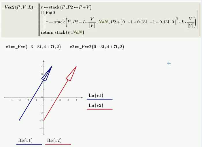

Sep 19, 2024 2:09 PM UTC
You would need to plot the arrows 'manually', which means you have to create a plot consisting of at least 3 line segments forming the main part of the vector and its arrow heads.

Or you could define a vector by start and end point and length of the arrow head. Here is a slight modification of the arrow function in the vector field sheet - the absolute length of the arrowhead is a separate third function argument and its not relative to the vector length.
"Vec" is a wrapper for "_Vec", it awaits start and endpoint as 2x1 matrices and the arrowhead length as its arguments.
If you like it more you sure could easily modify it so that the second argument is the vector itself - simply replace P2-P1 by P2 😉

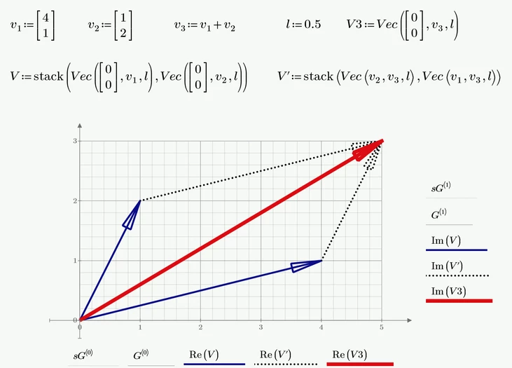

Another example
You can see in the linked worksheet for vector field plots the modification necessary for a differently shaped arrow head
P10 worksheet attached
