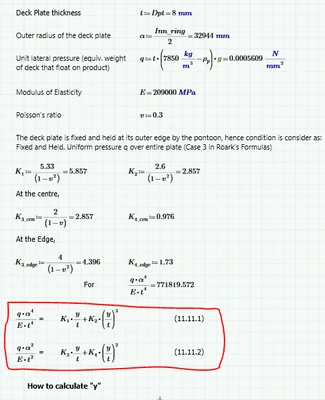

January 8, 2020
How to to calculate "y" in the below mentioned equation.
