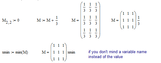

Are you referring to something like this:
Else, provide an example of what you're looking for.

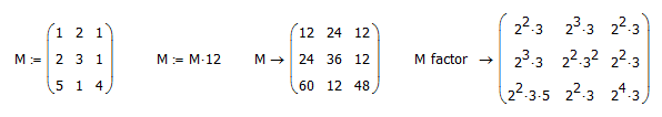

I don't think there's any way to do what you want. You can factor the matrix, but even in cases where that changes how one or more elements are displayed Mathcad does not pull the common factor(s) outside the matrix:

I'm not sure whether you want to automate the process or just manually adjust it.  If the latter, then you put the common factor in the units placeholder ...
Stuart

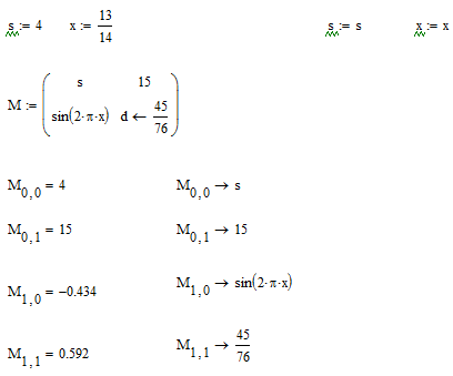

Symbolic result doesn`t have unit placeholder in MathCAD 15.
23-Emerald V
April 12, 2016
Correct.
The symbolic processor isn't aware of/doesn't handle units, it treats them as (unknown, if applicable) variables.
So with symbolic evaluation Stuart's method doesn't help you. Numerically it does.
