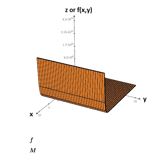

How to put labels on axis for 3D plot?
For 2D plot we can see labels somewhat on the axis to see what axis is assigned to what variables for better understanding:
My question here for 3D plot: Is it possible to put labels on the axis like I shown below?

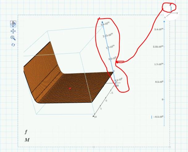

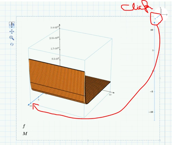

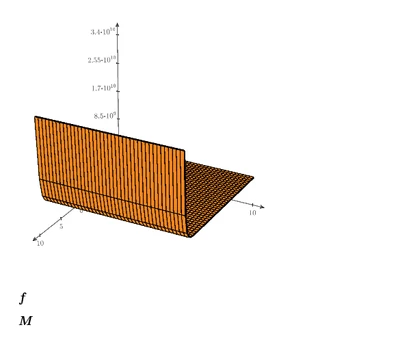

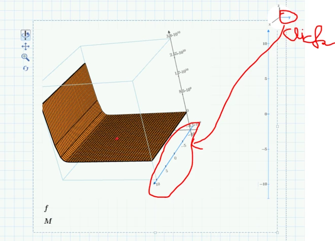

I think I found something, the axes light up when we click:

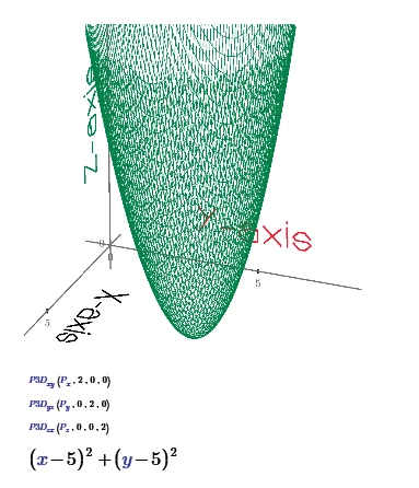

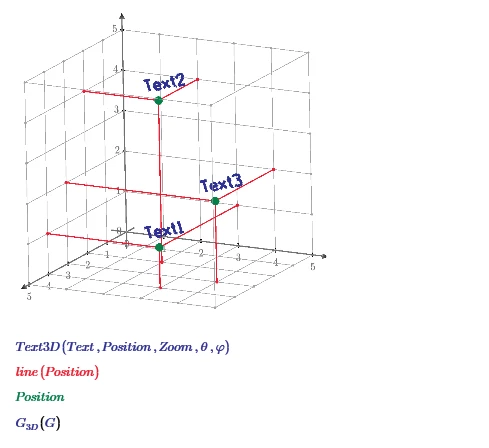

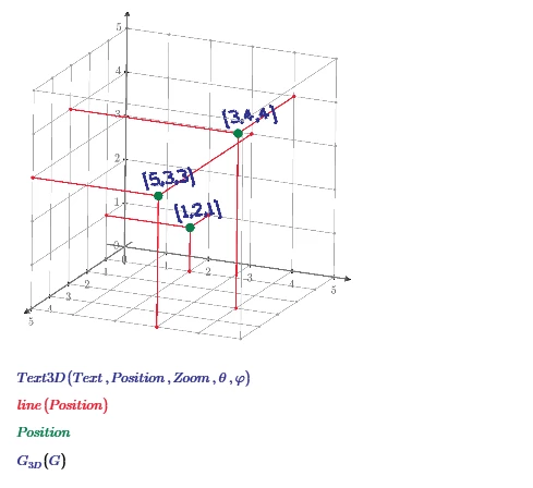

Before, Luc shows how to plot ASCII text in the 2D or 3D plots.
