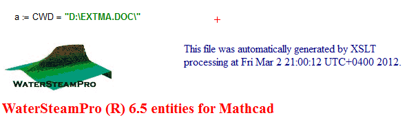

There is a built-in variable CWD which contains the current working directory as a string, but unfortunately there is no variable containing the filename,
