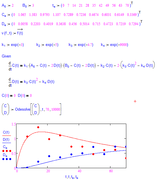

in the book chemical kinetics with mathcad and maple, Figure 4.22 illustrates a very useful and interesting method to answer a reversible kinetic question,
after reading this example, I wanna rewrite it, for I think that Odesolve block is easier to read than Rkadapt() function. But during the recoding , I found that I
must change k to k(t), but this would not bring too much trouble during solving the ODEs. the problem arised during optimization, see the figure
