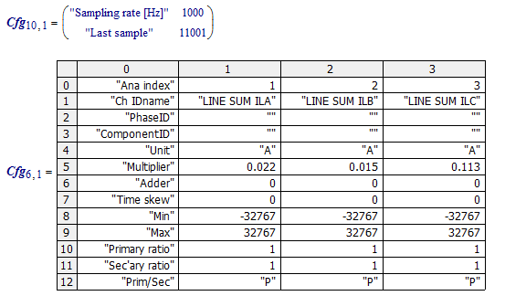

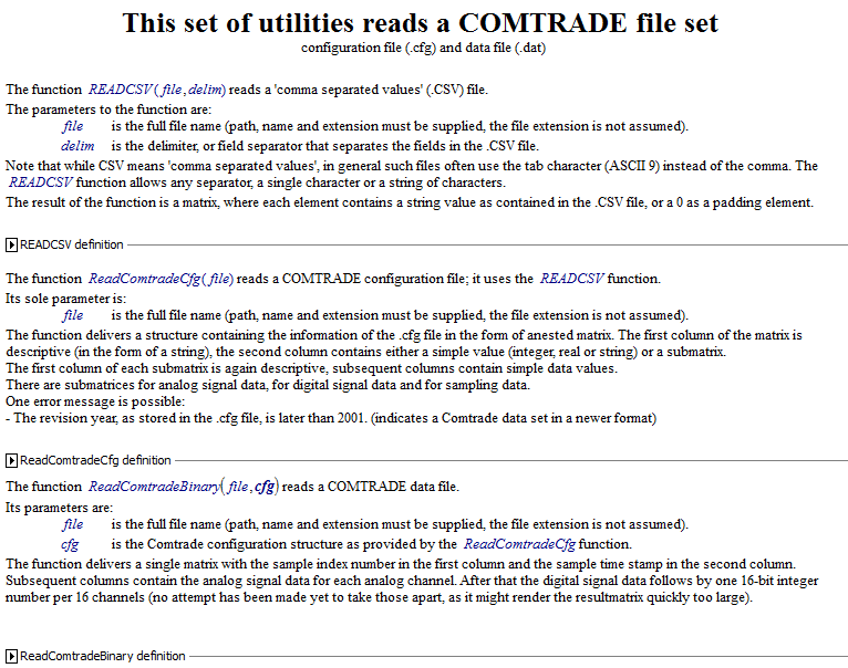

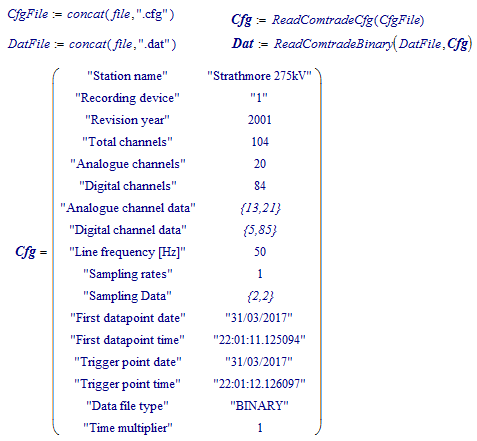

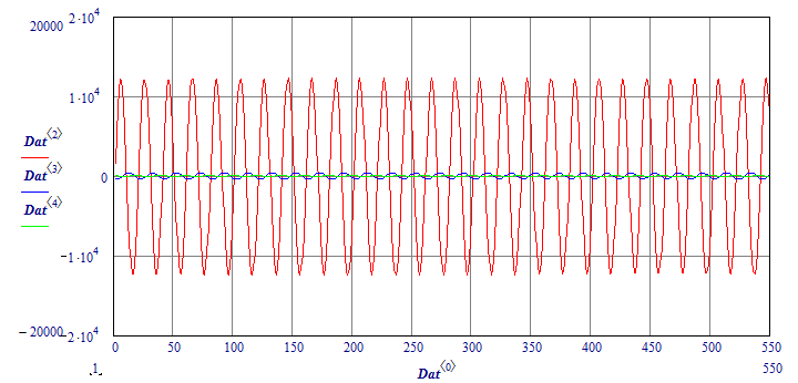

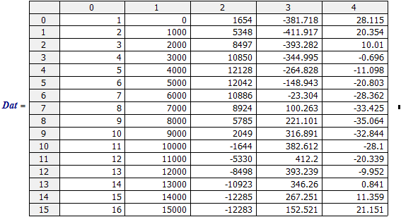

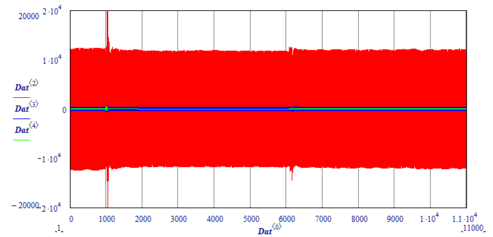

It's done.
Results:
Let me know if you like it.
