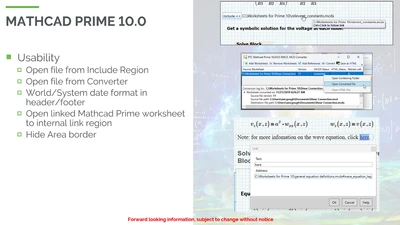

May 22, 2024 10:55 AM UTC
Prime 10 now offers the feature you request - hiding the line.
Unfortunately still no way to show a border, highlight the area itself, assign a name for the area which is displayed or automatically apply and show the date of last edit ...
