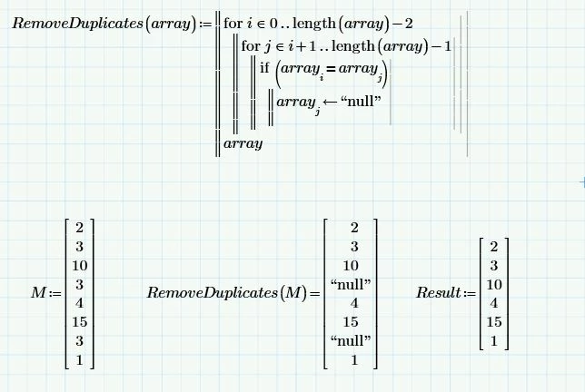

I'm trying to create a program that removes duplicate entries from an array (vector) in Mathcad.
I have managed to write a program that converts all the duplicates into "null", but is there a way to get rid of the elements completely and get the "Result" array?
Thank you.
Best answer by Werner_E
Always better to post the worksheet as well as we don't like retyping things.
change "null" to NaN and use filterNaN(array) at the end of your program (instead of just array).
As an alternative after replacing duplicates with "null" you could use  trim(array, match("null",array)) at the end.
March 28, 2018
Quick and easy solution to my problem. Thank you!

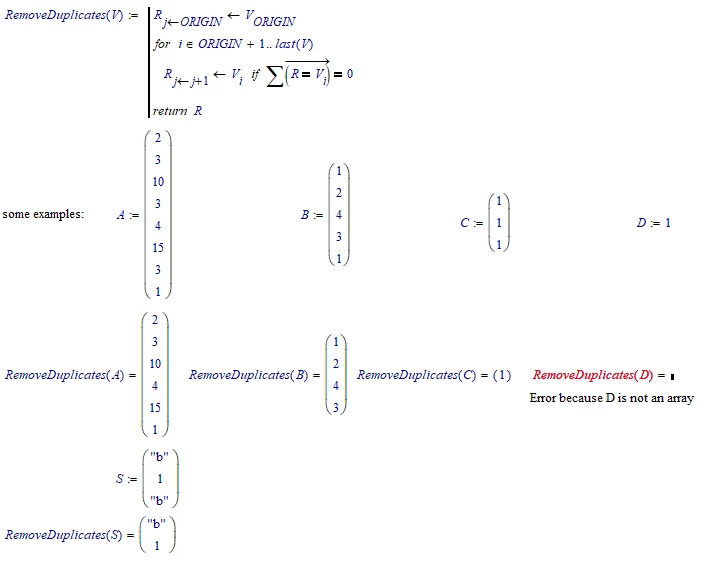

March 27, 2018
Here's another implementation:

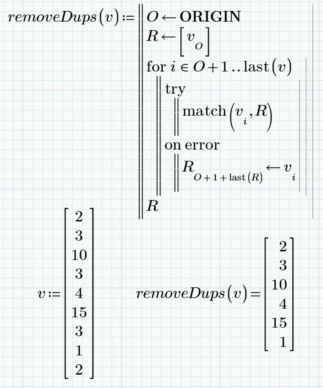

March 27, 2018
Clever way, like it!
It inspired me to the following variant:
Its so much smaller in real Mathcad:

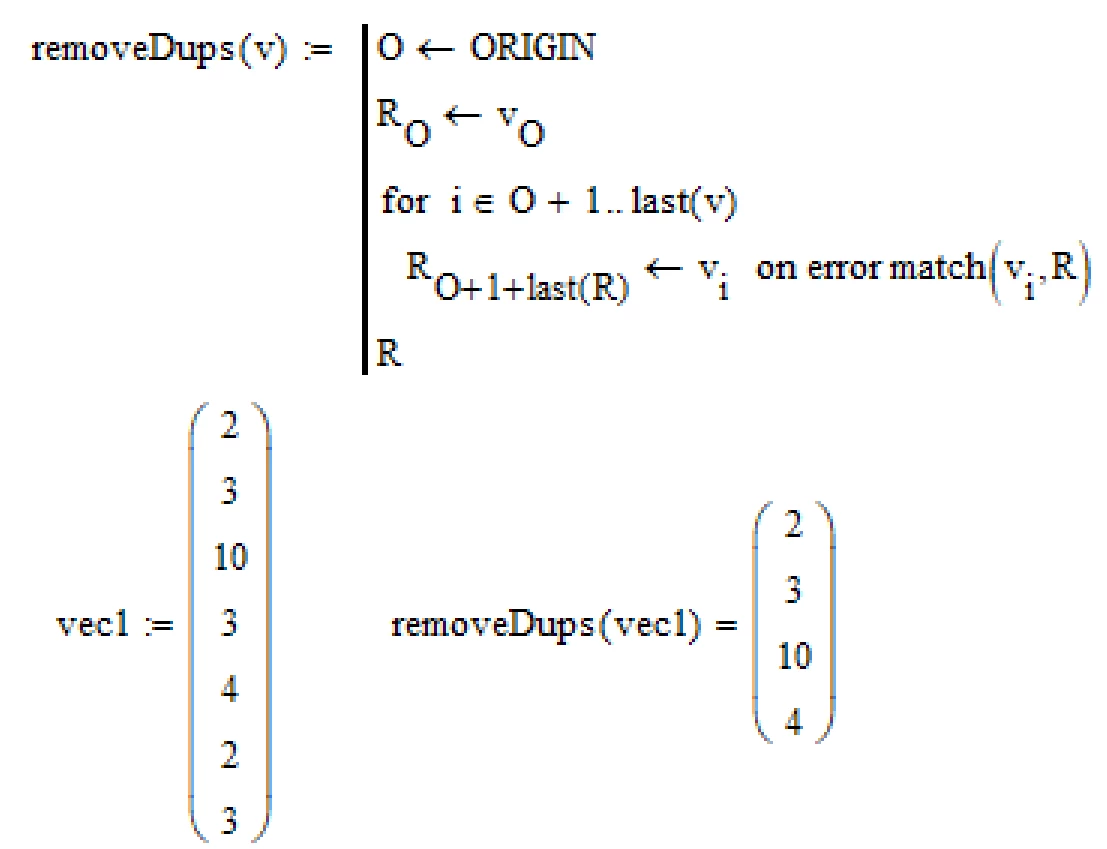

March 28, 2018

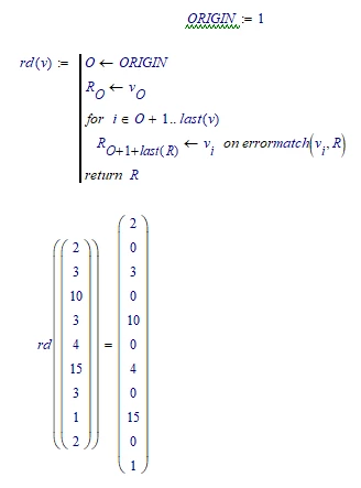

Werner
I'm not sure your implementation works for ORIGIN=1.
You have an O+ in the index of R when assigning a new member, together with using last(R); that adds another (empty, or 0=zero) with every addition of a member.
OK.... I'm sure it does NOT work as intended for any value of ORIGIN other than 0.
