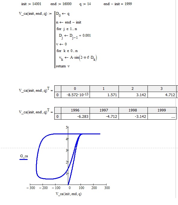

How to remove straight line occurring in the middle, while plotting G_ca vs V_ca
Hi all,
In my code which I attached below,
I am getting a straight line in the middle, while plotting G_ca vs V_ca
How can I remove the straight line occurring in the middle of the plot between G_ca vs V_ca.
I attached my code below.
Please help me.
Thanks.
Hi.
The origin of the line, are the zeros before 14000 in V.
The solution, remove them from the vectors.
Best regards.
Hi.
Best regards.
