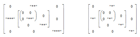

Is there a somewhat resonable way to start with a complex nested objects like
and end up with either of those
which means that every number existing within becomes zero and every symbol (or string of symbols) becomes some placeholder symbol (I chose '*' for no particular reason).
How should I accomplish this?

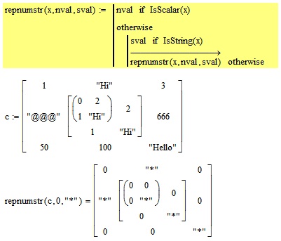

For values of "reasonable" ...

This, kind sir, is beyond good.
That would have taken me a long time...
23-Emerald V
May 28, 2012
No worries. Although many people don't like it and go out of their way to avoid it, Recursion is your Friend with nested arrays (and lots of other things!).
