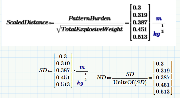

I would like to return vector values to scalar ones. How do I do this?
Example:
I would like the above matrix returned without units.

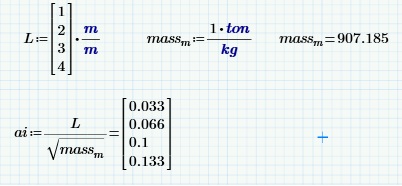

Stripping units can be dangerous.  One way is the "UnitsOf()" function
Note that if you specify your variables in non-standard units, the values will be adjusted:
Turning a vector (or list of values) into a scalar requires a better understanding of what the application is.
