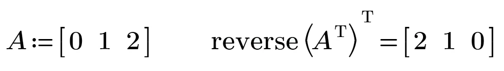

How to rotate image without using "rotate" keyword in mathcad?
Example: A=(0,1,2) now by using rotate keyword Result = rotate(A,180); Result = (2,1,0). But how to do this without keyword ?
11 replies
September 29, 2018
May be this help you
September 29, 2018
yes i'm aware of that but how to do for random degrees for ex:  rotate(A,41) or rotate(A,33)?

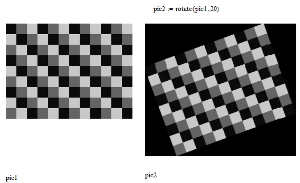

"rotate" is used to rotate a picture(matrix) by a given angle in degree with some sort of antialiasing.

Yes i'm aware of that keyword but how to do without keyword ? or is it possible to see how that "rotate" function program has written in mathcad ?
September 30, 2018
You haven't answered my question which simply was: WHY?
No, not that I would be aware of. The algorithms used in Mathcad are not a secret but are hard coded and so can't not be inspected unless you have access to the source code of the program.
As far as I am aware many algorithms implemented in Mathcad followed the "Numerical Recipes" and the four volumes of "Knuth - The Art of Computer Programming" but I am not sure if this also applies to the algorithms for manipulating bitmaps.
But if you study Books about computer graphics you sure will find various ways and algorithms how to rotate a bitmap picture and implement anti-aliasing.
Searching the net will reveal a lot of possible implementations, too. Some less, some more elaborate.
As one example you may ave a look at https://www.codeproject.com/Articles/12230/Anti-Aliased-Image-Rotation
