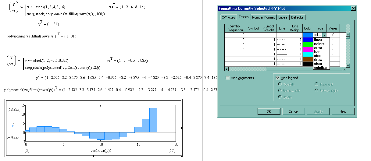

How to select 2d bar plot
I know about 3d bar plot in mathcad.
But, I want to how to plot in 2D bar plot,
I also tried by using,
format--> graph-->trace
If I do like this, In my mathcad window, I could not able to select the trace tab.
Thanks.
May 5, 2015 10:43 AM UTC
Right click on the graph, select format -> gives a pop-up window.
select the traces tab, and at the end of the table there is a column labelled Type (you may need to scroll across).
change this to 'bar' for your trace & hopefully problem solved

vveeran4-ParticipantAuthor
May 6, 2015 12:33 AM UTC
The problem is solved.
Thanks Westerman and StuartBruff.

May 5, 2015 11:26 AM UTC
Just to add to what Andy said, there are two types of bar plot: bar (which is the one in Andy's worksheet) and solidbar as in the image below.
Stuart
The image below shows the effect of applying a solidbar format to a 2D plot. The image shows that you have to move the Trace scrollbar to the right and the 2D plot format choices, including bar and solidbar.
