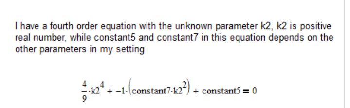

Hi All, I have a 4th order equation for an unknown parameter. The equation includes some constants whose number depends on the external setting.
The parameter must be a positive real number. In the attachment, I listed two possible symbolic solutions k2_1 and k2_2.
How can I set the if else condition correctly to achieve the following requirement?

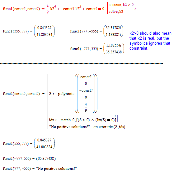

(1) if both k2_1 and k2_2 are real and positive, show both of them as the solution of k2
(2) if only one of k2_1 and k2_2 is real and positive show this real number
(3) if neither k2_1 or k2_2 can satisfy the positive real condition, show an error message

Maybe something like the attached.
As you can see, as so often the symbolics ignores some constraints given via "assume".

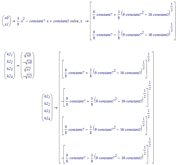

Introduce a new variable, e.g. 'x' with as definition:
x=k2^2, then your equations turns into:
       (4/9)*x^2 - constant7*x + constant5 = 0
You can use simple school mathematics to solve x.
Then k2 values are found by taking the positive or negative square root of x.
23-Emerald V
There are only 4 possible solutions (because it is a 4th order problem)
They are found with:

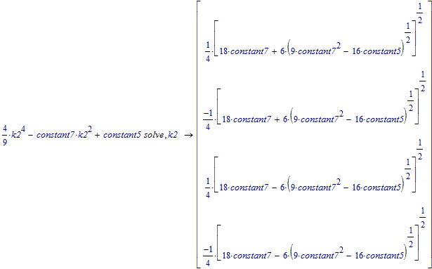

The other option is to ask Mathcad to solve the 4th order straight away:

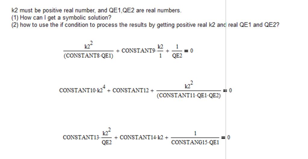

Hi Werner, I have a similar but more complicated calculation.
Now I have three variables with several constant numbers (depending on external setting). How can I get the symbolic solution of three equations?
My variables are k2, QE1 and QE2. Are are real numbers, and k2 must be positive. Would you teach me how to solve it symbolically?
It seems like I am not allowed to upload another worksheet in this thread. If you want me to open a new thread to upload the worksheet, I can do that.
Thank you!
