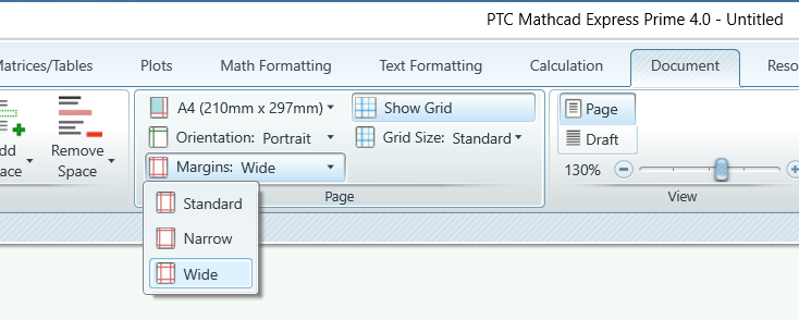

How to set the height of header and footer, Every office program can adjust it, how to adjust it in MP3.0?
Sometimes i can adjust all the equations to only one sheet if i can set the height of header and footer.
The height of header and footer sometimes is too large for me.
Best answer by LucMeekes
The only thing I find is that you can set the page margins, but you're restricted to one of three options:
LucMeekes23-Emerald IVAnswer
March 17, 2017
March 18, 2017
Thank you for your help. It is the only way so far.
