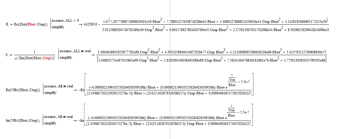

Thank you very much, Alan. It's very helpful. Learn a lot from your tips. But please allow me to ask another question.........
I runned your attached file but yours stopped at the calculation of C with no result.
This happened to my original file as well, but mine gave me something as below. It just fails to extract the imaginary part of Ztot.....It doesn't make sense to me as it's able to get the real part....
Aug 20, 2014 5:22 PM UTC
Hard to be sure without seeing the file, but if you click on Im(Ztot) you will probably see a multiplication between the Im and the parenthesis, so it sees Im as a variable, not a function name.
