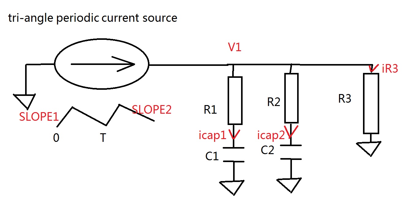

Hi All, I have a circuit like this, where I want the components value R1,C1,R2,C3 and R3 as the user inputs.
I can list the equations to solve this circuit, but I do not know how to realize it in Mathcad. Would anybody help me?

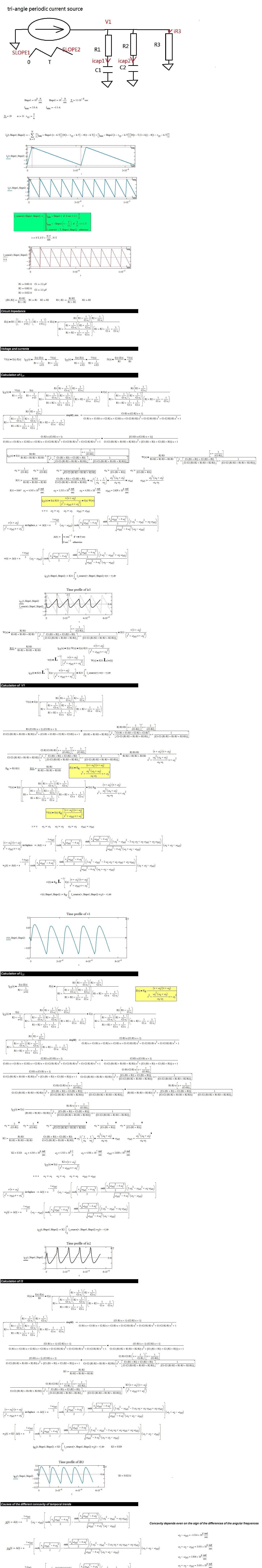

I would analyze the circuit as follows (a little rushed and without comments):

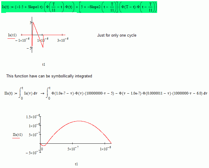

Hi.
If you have the symbolic solution, can use this definition for Isource, which can be differentiated and integrated symbolically.
If you want the numeric solution must to write an odesolve block with the functions that you have write, and your periodic function works for the block. But need to write in therms of the variable t, so, integration variable must to be tau or something else, and t goes at the top limit of integration: I don't understand why you put T, the period there.
About a push button to make the calculus, mathcad usually don't need that: it recalc every time that something changes in the screen area.
Best regards.
Alvaro.

August 1, 2016
Hi. Attached, the odesolve block, trying to resolve the integral equations to differentials. But can't make it to work with odesolve. Maybe another one collab can see why.
Notice also that for t=0, it's wrong to assume i1, etc equals zero. Maybe you can translate the Is to make it zero to t=0.
Symbolic solution attached to, but it's useless.
Best regards.
Alvaro.

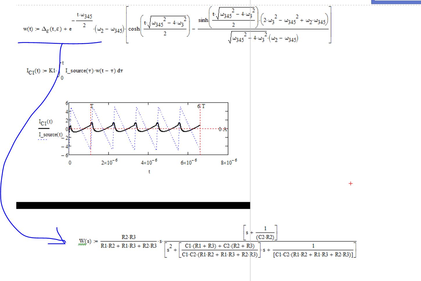

Hi F.M., thank you so much for your detailed solution! I have the questions of three calculated/defined variables, would you advise?
(1) what is the DELTA(t) provided by inverse laplace?
(2) what is the epsilon you defined?
(3) what is the theory in defining delta_epsilon(t) to replace delta (t)?
Thank you!

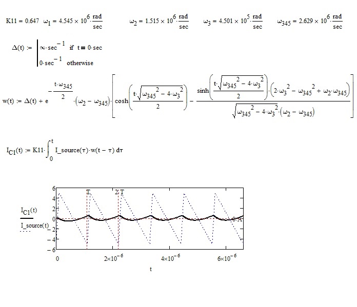

August 2, 2016
Hallo yhuang-3,
the delta is the Dirac impulse. It is an impulse defined in the origin (t = 0),  of infinite amplitude and unit area. The analytical definition, approximated and simpler, is the one I provided, but there are many others. You get it to the limit, for epsilon approaching zero. The topic is covered on all texts on calculus. The Dirac delta is commonly used in physics as well as in electrical engineering. I did the approximation of the Dirac pulse, only to draw the graph. Indeed, the approximation is not necessary. Better to use the definition of the Dirac pulse, as you can see in the following image.
In laboratory practice, you have to be very attentive to the voltage and current pulses. They can destroy the user systems and measuring instruments. The classic case is the output of a differentiator when the input is a square wave signal. The output that is obtained is a train of destructive pulses.
In your problem, being the impulses integrated, there is no production of pulses.
Greetings
FM
August 3, 2016
Attached, numerical solution. As any numeric procedure, can fail for some combination of parameters (bad-conditioned problem).
Can't get the correct Derivative vector for call rkadopt, and others, but Odesolve works, at least, for few periods.
Best regards.
Alvaro.

Hi F.M., I have another question about your solution. Would you tell me how did you express W(s) in trying to plot v(t)? I found that using laplace function, I cannot get W(S) from w(t). Thank you!
August 5, 2016

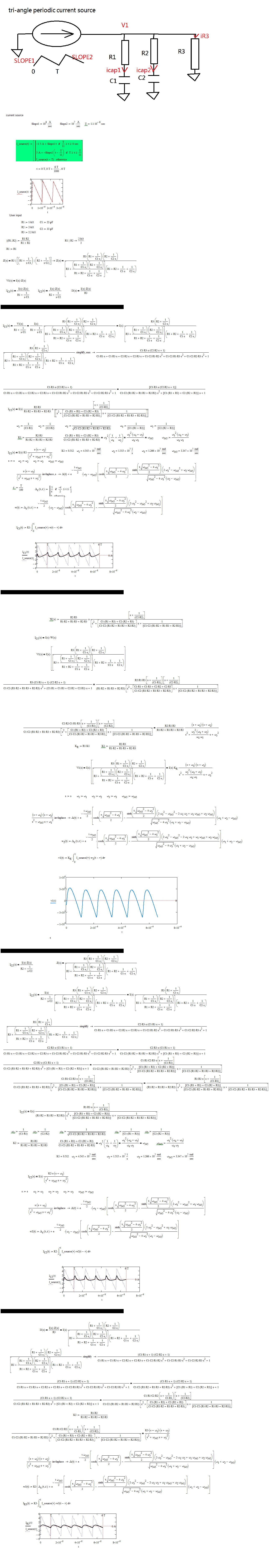

Clarification: 1) In mathcad 15 isn't necessary to approximate the Dirac's delta.
                        2) for your problem see below and the attached worksheet
Bye
FM

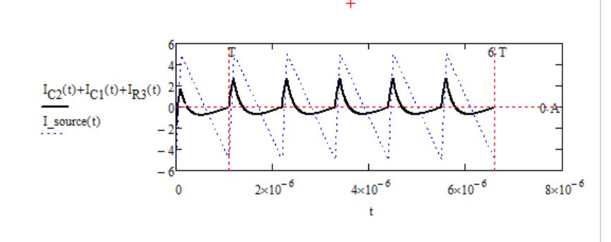

I tried to use your initial worksheet and your latest worksheet little network.xmcd to sum I_C1,i_C2 and i_R3, and I found the sum of them do not equal to I_source(t), you can see the comparison here:
My questions are
(1) my first priority is to plot a relatively accurate V1(t), do you think the concavity issue or anything else will impact the plot of V1(t)?

I would like to give you some advice, concerns the circuit presented by you is really an unacceptable draft, unpresentable. You should have draw a circuit like the one here below:
Greetings
