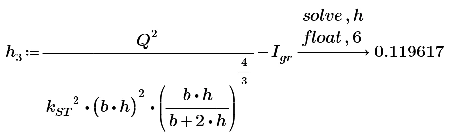

Today I made my work for Hydrodynamics. It's about this Equation:
Every Variable except h2 is calculated before and so I'm looking for h2. I have no idea how this could work, the solve function does not work.
Pleas can you help me out with this Problem?
Thenks a lot 😎

Here is one way to solve it:
(Note that a symbolic solution is not found,
I guess because the order of the function is too high.)
6 replies

Please attach your worksheet so we can see what was going wrong.
The symbolic solve command should probably work OK.
But as all other variables are defined, I would suggest using a numeric solve block (with "find").

Thx a Lot for the fast Reply!
The File of this work is now attached. ... The Text is in German.
May 28, 2021
Thank you very much! 😎

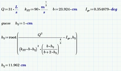

Solved using Prime 4.0 Express.  Openable in any later version.
Express will not calculate solve blocks, but the root function will work.
Shown as an example.
