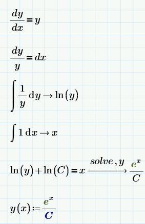

I have solved some differential equations (=DGL) with the Laplace-Transformation, which solves the DGL automatically.
feel free to check it out and try using the Transformations.

April 20, 2017
Impressive!
