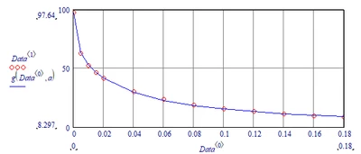

Newbie question...if I have a matrix of data values as shown below, how can I get Mathcad to solve for the actual polynomial (or exponential) expression ?
Or stated another way...can Mathcad provide the actual polynomial formula that would produce the graphed curve below based on the data provided.

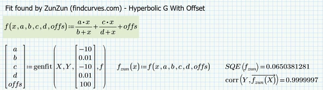

I tried the site suggested by DJf (I knew the site as ZunZun from former times) and it was indeed able to find the best fit so far
I added it to my sheet
With free eyes you hardly can spot a difference to the best so far.

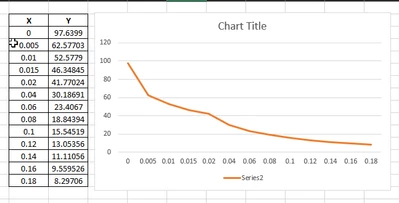

From the pic it doesn't seem to me that a polynomial or an exponential would be a good fit - but you are the one who should know what process the data stems from and what kind of function can be expected.
BTW, from the spreadsheet screenshot it looks like you had chosen the wrong plot type in Excel as the x values are shown equidistant which they actually aren't.

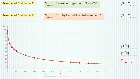

My guess is:
with
So use genfit.

Can I assume that genfit produce these...
How did you arrive at this formula...
As Luc wrote - he guessed based on his experience that this type of function might give a good fit (and it looks like it actually does).

Werner_E25-Diamond IAnswer
Main difference seems to be at the front values
