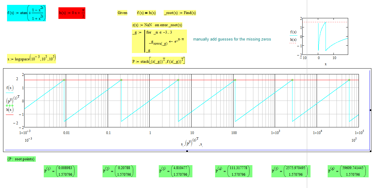

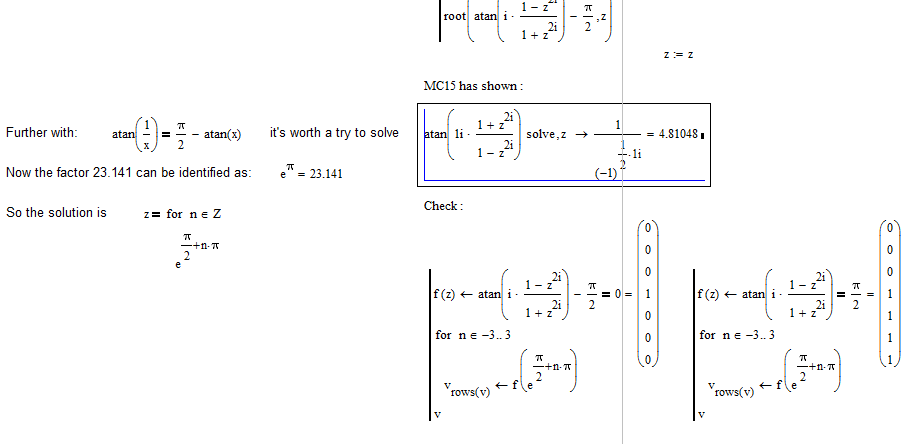

How to solve, fully atan(1i*{1 - x^2i}/{1 + x^2i}) = Pi/2 ?
  Hello, Everyone.
From :
The question : How to solve, fully atan(1i*{1 - x^2i}/{1 + x^2i}) = Pi/2  ?
   Thanks in advance.
        Regards.

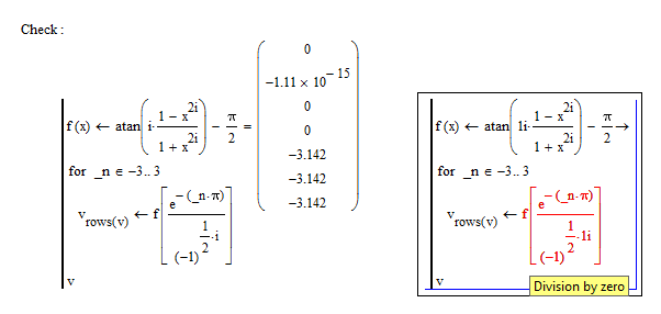

   Many thanks, Valery and F.M.
   F.M., And Check with MC15 then :
          Regards.

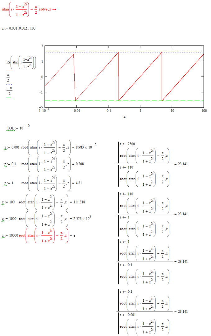

Does this help:
LucMeekes23-Emerald VAnswer
23-Emerald V

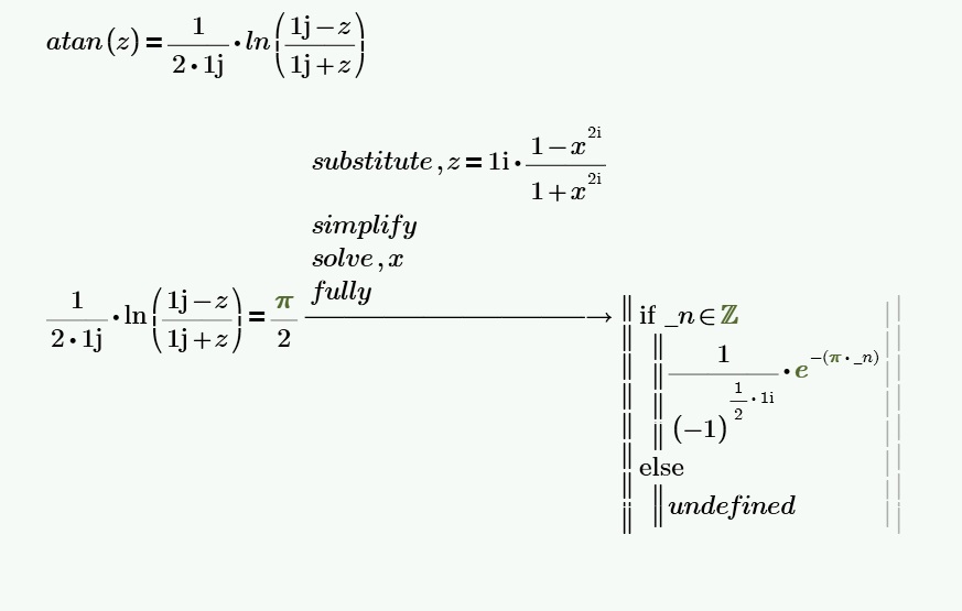

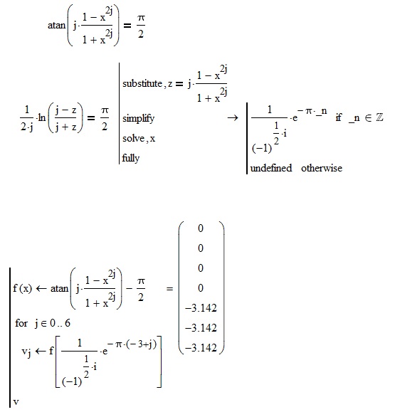

lvl10720-TurquoiseAuthor
20-Turquoise
And I base on Werner's suggestion :
     Best Regards.
