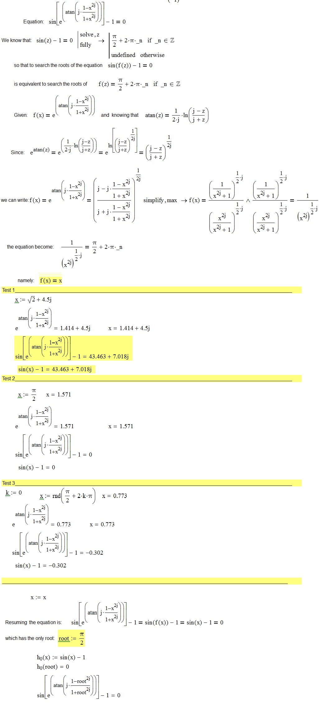

How to solve sin(e^{atan(1i*[1-x^2i]/[1+x^2i])}) - 1 = 0 ?
  Hello, Everyone.
  From :
       Thanks in advance.

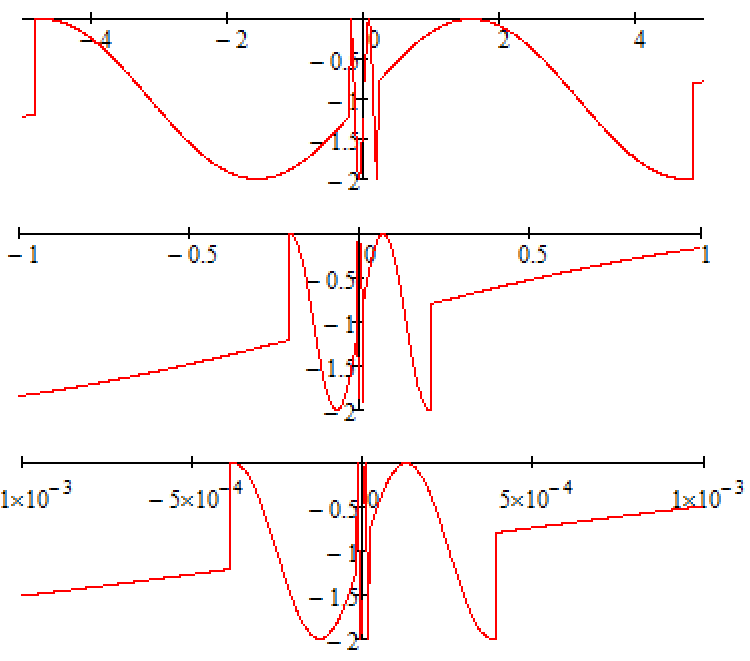

Why do not you use plots
January 29, 2017
You could re-hash the problem as follows:

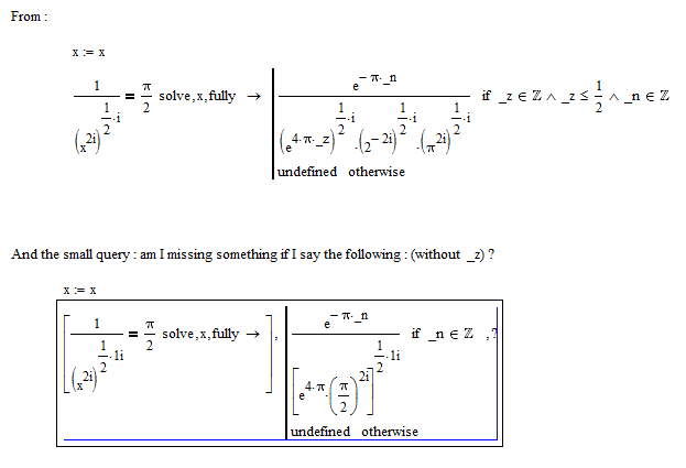

  Many thanks, Valery, Alan, and P.M.   . Your three of answers are very helpful to me. And I have a small query as the following :
            Best Regards.
