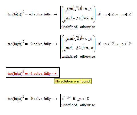

There is no solution!
Why do you think that this is a solution??? Its obviously not:
  How to solve [tan(ln(x))]^2 = -1 ?
Why do you think that this equation is solvable? It is not!! No solution exists!
Because tan(x)=i has no solution!  atan(i) is undefined (singularity).

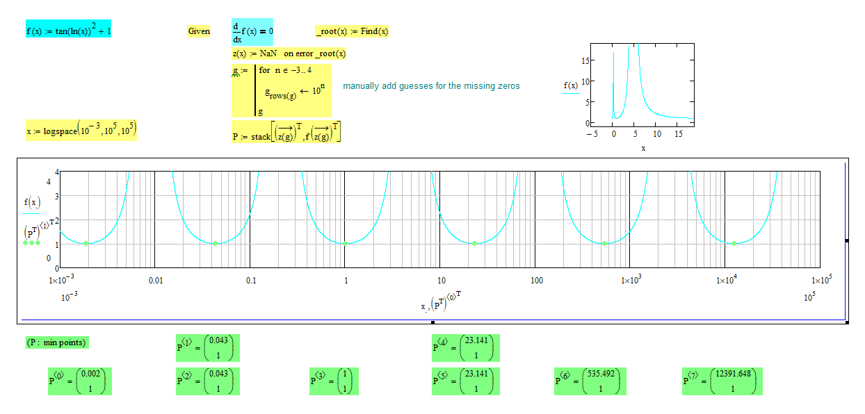

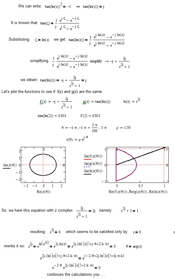

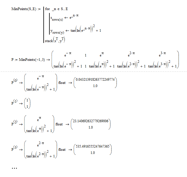

But I still guess :
Furthermore :
                Regards.
Werner_E25-Diamond IAnswer
