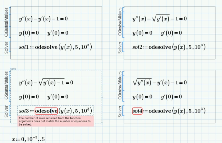

How to solve this types of non-linear differential equations like sol3 and sol4? There is a method for solving also these types of diff eq? Or is not possible?

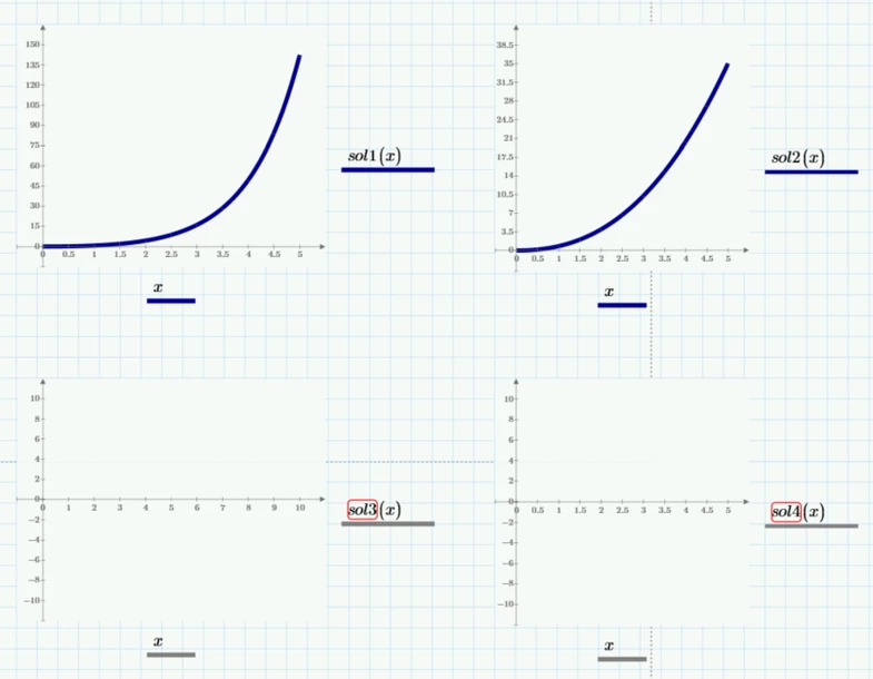

For sol3 set y'(0) = 1 to avoid a complex square root.
For sol4 rewrite as y''(x) = (y'(x) + 1)^2  and set the xlimit to be 0.99 rather than 5 as y'(x) tends to infinity as x tends to 1.
Alan
Jun 3, 2024 9:58 AM UTC
Ad sol3:
Wen you demand y'(0)=0 you also demand y''(0)=i, the imaginary unit! Really?
Chose y'(0)=1 or larger and the solve block works OK
Ad sol4:
Look at the help  -> ODE Function
It clearly states:
odesolve(vf, b, [intvls])—Defines a function that represents the solution to a system of Ordinary Differential Equations (ODE), subject to initial value or boundary value constraints. The ODEs must be linear in their highest derivative term, and the number of initial and boundary conditions must equal the order of the ODEs.
The square root of y''(t) sure is not linear.

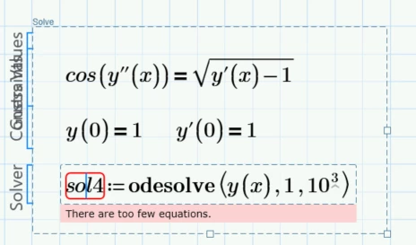

Cornel19-TanzaniteAuthor
Jun 3, 2024 10:18 AM UTC
Another example:

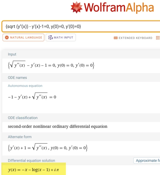

Yes, sol4 can be solved symbolically as well.
Its quite easy to to it with pencil and paper, as Alfred noted and I already posted the solutions.
I guess Maple should be able to solve sol4 as well
Wolframalpha can do so :

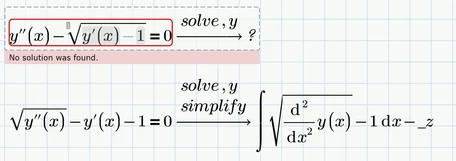

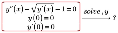

Primes 10 symbolic is not able to return a solution
The error message in both cases is "No solution was found".
Without the initial conditions sol3 still fails with the same message, but sol4 returns a useless 'solution':
Prime can only solve sol1 symbolically
It can't solve sol2,
which is understandable as this one is quite nasty and the solution could only be written using the Lambert W function.
See {y''(x) - sqrt(y'(x))-1=0, y(0)=0, y'(0)=0} - Wolfram|Alpha
